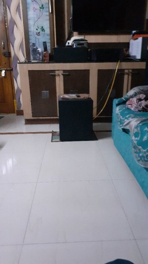

power amps especially high power ( unless Class D) need space around them to breathe/dissipate heat and putting one in top of there is not recommended. if you can use 4 thick wood pieces to raise the AVR 3-6 inches above it might still work but preferably give it space.

My avr maranz 50. I want to keep avr on power amp. Goong with O&B power amp
my sub is 48cm height . Want the second shelves of av rock at 53 cm height and fitst one at a height of 65cm. 4 legs of av rock on 4 sides of sub. So that sub comfortably postioned below the av rack.
Above the sub planning a 2 shelves rack. Sub 48cm height
