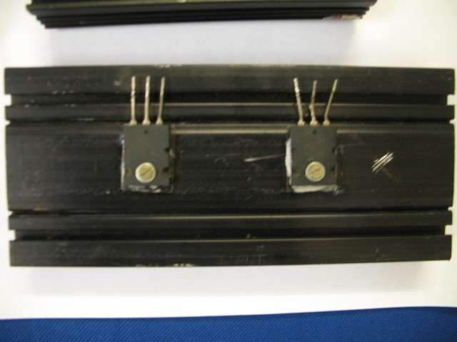

A conventional transistor has three terminals for connection to an external circuit. A voltage or current applied to one pair of terminals changes the current flowing through another pair of terminals. Since the output is much more than the input, the transistor provides the amplification of a signal.

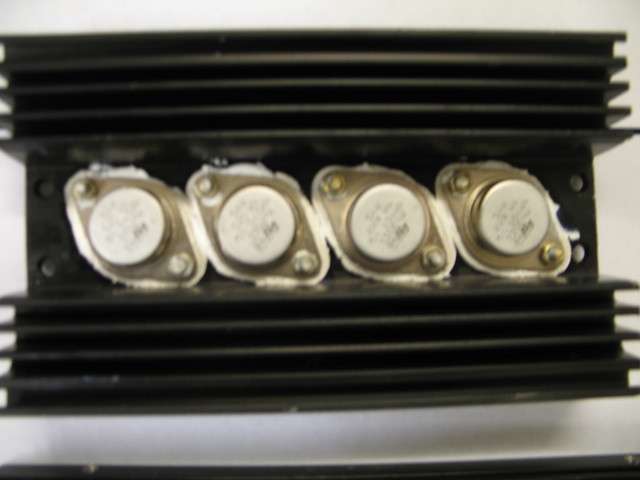

(Conventional transistors used by Craftel)
Conventional metal gate transistors are circular in shape, and have two small extensions on two sides for bolting onto a heat sink. The terminals come out at the bottom where the circuitry is implemented. Because of the amplification, transistors get extremely hot, and hence the need for heat sinks. There is certain size below which the metal transistors cannot be reduced. Thus the circuit boards have to be large to seat all the transistors and their related heat sinks during various stage of amplification.

What do you do if you are small company with an interest in bringing out audio products at reasonable prices? What if you dont have the capability to design highly integrated circuits nor the manufacturing facility to produce these circuits? What if your volume of production does not justify these high costs?
Though the space required may be higher, why not go back to using metal-gate transistors? Why not mount the transistors in proper heat sinks and design an amplifier that way?

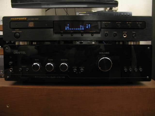

The Retro1100 Integrated Amplifier
The amplifier supports two pairs of speakers, a pair of headphones, and has brass, treble, and balance controls. The amp has six inputs including Aux, DVD, CD, and Tape. It has a line out for recording purposes. All these are connected through conventional RCA sockets which have been chosen to keep costs down. But there is a caveat. Mark has also introduced a pair of high grade gold plated RCA sockets that can be used with a CD player for listening to music. These terminals do not go through any switch, but are directly soldered to the pre-amp gain section. Based on your requirements, these terminals will eat up one of the other terminals. In other words, if you choose to use these terminals for CD, the regular CD socket will not work.
(A front view of the Retro 1100)
(Side view)

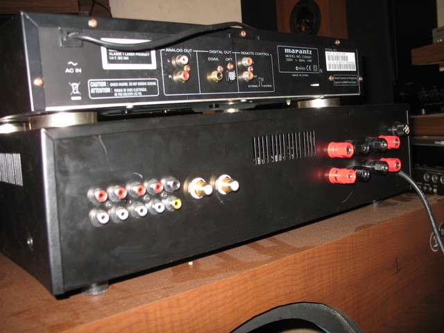

(Rear view of the Retro1100
The amplifier also has a HiFi Filter to be used with turntables. This cuts of all signals above 16kHz, essentially cutting off the irritating scratch noises of vinyl albums. There is also a loudness button that truncates very low frequencies and very high frequencies. My guess is less than 50Hz at the lower end, and more than 16kHz at the high end. This is only a guess. The advantage is that you will hear the mid frequencies with greater clarity.
The Retro 1100 is a Class AB integrated that switches from A to B at around 20 watts. Mark prefers to say that the switching is done in stage three out of a total of 5 stage amplification.

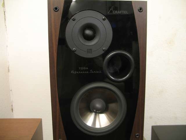

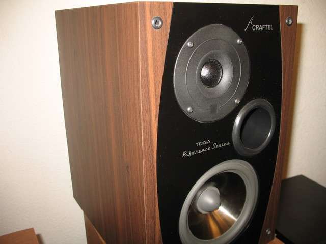

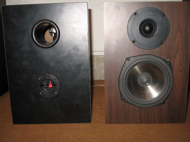

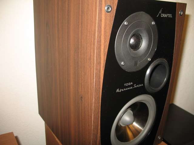

The Bookshelf Speakers
The bookshelf speakers are called Toga Reference. There are two versions available. One is the standard rear firing ported speakers, and the other is front bass reflex ported. The speakers have a dimension of 7" x12" x14" (w-h-d). The drivers, according to Mark, has been made specially for Craftel and the LF and HF drivers have been matched for each pair. They come marked as a pair, and if one of the drivers is damaged, the whole pair has to be set aside. The HF driver is a silk dome tweeter made from non resonant poly carbonate body with flare. The LF driver is a 5-1/2" titanium cone woofer designed with rubber surrounds and a spider (M-Series) for controlled excursion. The voice coil rests on an aluminium frame with side ports on the basket for cooling
(Front view of the Toga Reference)
(Another front view)
(Another view)
(The rear of the Toga Reference with Mark holding it in his hand for size reference)
(The Toga rear firing ported speakers with combined front and rear views)
The speakers are rated at 75 watts into 4 ohms. They are magnetically shielded, meaning they can be kept next to your TV. They have a high sensitivity of 91.2 db. The cabinet is made of 3-1/4" MDF with twin layer front panel.
The speaker specifications match well with those of the amp.
The amp was connected to the speakers with a 16AWG Belden cable terminated with gold plated banana plugs at the amp end. At the speaker end, the cables were connected using bare wires.
Mark used a Marantz 5001 CD Player. This was connected to the amp using a RG28 ICs terminated with Nuetrik banana plugs. The RG28 is used for professional equipment, has 19 strands of tinned copper with 34 AWG tinned copper braid shield and 34 AWG galvanized steel shield. The dielectric as well as the outer shielding is rubber.
