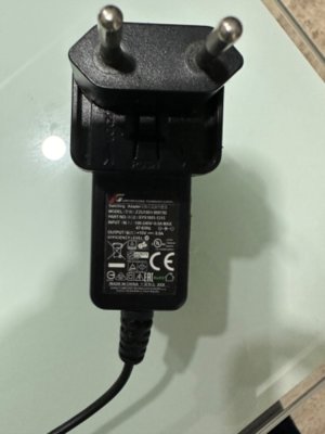

Kindly suggest places to find power adapter for project essential 2 usb record player
Mine blew away.Anybody tried compatible ?

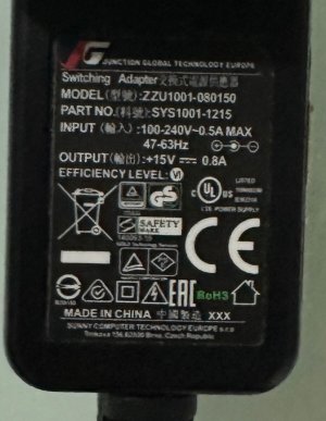

Your curent adaptor is a SMPS. So any 15v adaptor with equal to or more than 0.8A current will do. You just need to see of the DC barrel plug is of the same size.
If not you will have to cut the wire in your current adaptor and fix it to the new adaptor and ensure that the outer barrel is negative and inner pin is positive.
