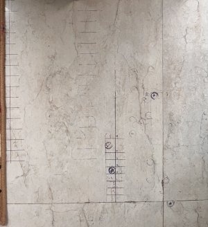

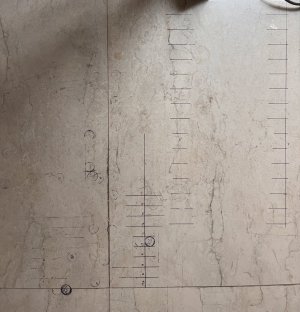

We all understand that the room is the most critical component of a music system, though many of us might not fully appreciate its impact. I was no different. While experts often emphasise precise speaker placement down to 4-5mm and its effect on sound, I only started noticing changes at around 5-6 cm.
In my discussions with prem he would always mention about his speakers locking in by movements of 5 mm and could never really comprehend it ! Last week, Prem was in town and I experienced this firsthand in my own home and felt compelled to document it before I forgot :)
One crucial concept to grasp is how frequencies interact with the side and back walls. According to theory, certain nodes in the room allow the speaker to lock in, minimising bass overhang, preserving mids, and ensuring smooth, well-timed music flow. Typically my placement was with speakers about 2.1-2.2m from the back wall and 4 ft from the sides (one-third), achieving good bass response. However, certain albums like Nikaah and Aandhi always sounded shrill in the high frequencies with weak bass, which I attributed to the recording quality. Most of my friends in Audio agreed
So when Prem offered to help setup my room I jumped at the chance . At the end the transformation was remarkable when we adjusted the speaker position to find the "The Spot." which was between 3-5mm only beyond which the balance of music changed
Getting into the details, my room measures 18 ft by 12 ft with a 10 ft ceiling. It's rectangular with doors behind the listening position and a large window behind the speakers. Using a digital distance measurer, we ensured precise adjustments, typically done by ear.
We started with one speaker, playing a single channel to make it easier for me to grasp what Sensei Prem was hearing. Initially set at 2.2m, the balance was off with high frequencies too prominent, bass weak, and mids cut off. Prem directed and I gradually moved the speaker back by 5cm increments until we found the right spot at around 2.05m. Then, fine-tuning with 5 mm adjustments, at approximately 2.053m, the room acoustics just locked in. The moment I moved the speaker, I could detect a subtle "click" in the sound quality.
We repeated this process with the second speaker, and put the music on stereo and suddenly, the music flowed seamlessly.
We then tried this setup at @reignofchaos place with his ATCs. Both ROC and I quickly identified the point where the music just flowed while Prem directed the positioning - it took about 30 minutes to find the optimal spot and the result was really surprising.
Later, @Dr.Bass joined us at my place, and we repeated the process again in my room. All three of us pinpointed the same spot, with noticeable improvements again and locked the place in. In the end, Aandhi sounded balanced without the shrillness, and Nikaah revealed only Salma's natural nasal tone. Mahendra Kapur’s voice never sounded so heavenly. Jazz and rock on digital sources sounded significantly better. Interestingly, the bass further improved after 5-6 hours.
Anyone who has visited Prem’s house and listened to his system knows how incredible it sounds. While the equipment choice is exceptional, the coup de grâce is the precise speaker positioning.
Quoting Prem, "Components are like ingredients for a dish, but making a dish taste good requires a skilled cook." I would add that even with the exact recipe, you still need a fine-tuned ear to get everything just right and since Prem has it, it was my luck that he was in town with the time to "lend me his ears " ☺️
Here’s to finding the elusive M-Spot 😇 . my room is at 2.053 which I have inscribed in my brain and now in this post .
