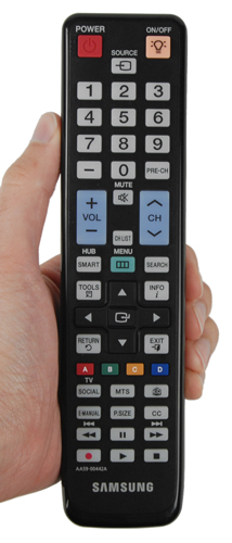

Are you trying that in a samsung tv remote or is it some universal remote or samsung dvd/blu ray remote.
I think you may have pressed the wrong buttons,since it works in all samsung lcd/led-lcds.
Which button did you press On/Off or power,since i can't recollect which of the two button i pressed,try with both buttons.

Yes, it's Samsung remote and tried quickly but all in vain. Any other ideas???
