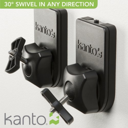

In order to place the ceiling and rear speakers, I plan to have wooden panel / beam running from above the TV panel to the ceiling - running across the breadth of the wall and and dropping back behind the sofa. This way the beam can hold the Atmos on the ceiling and the surround on the wall at the rear and optional lights.
If you have an option of getting something from US either yourself (or) thru your friends, check for Kanto ben co-axial speakers... YOu can buy wall mount too for these from the company..
A pair of co-axial speakers + speaker mount shouldn't cost more than $100.. If you can get 2 pairs, you can fix them straight on the ceiling using the mount, also has the provision of tilting towards your listening position.. which otherwise might be time consuming effort thru DIY way..
With $200 (or) lil more, you are done with 4 ceiling speakers & mount..
