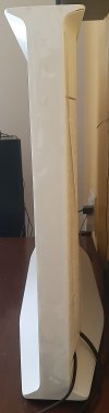

Just a day's research and my son bought this Samsung Serif ‘QA43LS01T’ TV. We have been enjoying it for a week now. It is supposed to be a lifestyle product.

For those who like legs – this has a leggy floor stand (4 legs and a conduit to hide the cable), This TV cannot be wall mounted. Have never wall mounted any of my TVs so it is not a factor for me. Stand is screwed on to the base - so no requirement for an installation. The leggy stand rather than invoking a lifestyle feeling, it just reminded my of the first black and white dyanora televisions in a shuttered wooden stand from the dinosaur era.

More pics and info to come as I learn more and other members comment!20201217_083403.jpg
