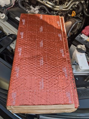

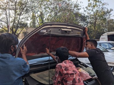

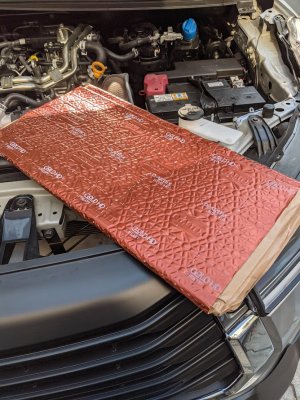

Got my Innova Crysta damped last year (2022) so not really current with what is available right now. All I can say that it makes a huge difference to the sound inside the car. It costs a pretty penny but completely worth it if you are particular about this.
The work was done by a local car specialist Car Sonics located on Minister Road, Hyderabad.
