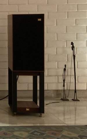

My four previous speakers came with thin sharp spikes that were practically useless on a marble floor. Bump into them and they could change position, and I always felt they would topple over if pushed hard.
The Lintons come with fat brass cones and brass pucks with a bit of felt underneath. Peter Comeau recommends four Blutack ‘peas’ to secure the speaker to the stand, which is what I’ve done. With a combined weight of ~33 kgs, the speakers are immune to my fat-bottomed friends. Yet, they can very easily be slid around to fine tune positioning.
I have no idea how this setup affects the sound, but it sure is the most practical one I’ve had in my living room.
