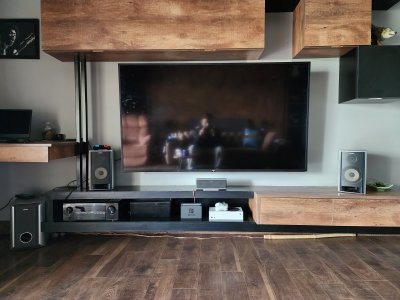

Hi everyone!
New to this forum and this is my very first post.
I enjoy film and music and have just started my Hi-fi journey.
Browsed a lot of threads on this forum, called up multiple vendors in Delhi and had some demos.
My choice was between Elac B5.2 and Q3020i and finally ordered 3020i as my front channels and 3090i as my centre channel due to space and sound issue.
(Will be powered with my new x1700 denon that I got last week)
For the sub, I've been recommended the qb12 due to performance and also it matching well with the consistency of the front channels.
My usage is movies:music 60:40 and I don't need very very punchy bass because:
1. I already have a dedicated HT room
2. I live on the 1st floor with my parents below my floor so don't want them to wake up in the middle of the night because of my film sessions.
What sub do you recommend under 50k?
(My room is approx 20 feet x 20feet and my Couch is approx 10 feet from the tv and front channels)
Attaching a photo which has my old sony HTiB speakers connected to the x1700 while I wait for the new QA speakers. (Ps: yet to do some cable management once I have the new speakers come in)
TL;dr - need sub recommendations for a sub under 50k for a 20x20 feet room.
Thanks in advance.

Unfortunately, unable to match the sub of the primary HT setup since that's an older Bose lifestyle HTiB system which I bought eons ago.
My Couch is about 10 feet from the tv and sub will be placed in the corner of the room so could you suggest some 10inch subs too?
( pic attached shows my sony sub in the same spot I intend to use..Sony sub is a passive one from old HTiB setup so kept there just for now)
