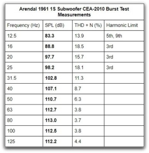

YES, starke will run out of power and yes tonewinner is going produce port noise for sure. any regular home audio sub of 12 inch size claiming to hit 20 hz is going to produce port noise and sound boomy. ( think - laws of physics)
any sealed sub under 15 inches will start distorting.
1725253542585.pngfound this on audioholics. It surely lacks authority below 30hz. expect the same under 30hz from any commercially available 12 inch subwoofer unless it it something like danley sound labs.
anything under 100dB for frequencies below 30-35hz is almost useless.
(note that the harmonics are of odd order- theses arent going to sound pleasant.)
View attachment 86391found this on audioholics. It surely lacks authority below 30hz. expect the same under 30hz from any commercially available 12 inch subwoofer unless it it something like danley sound labs.
