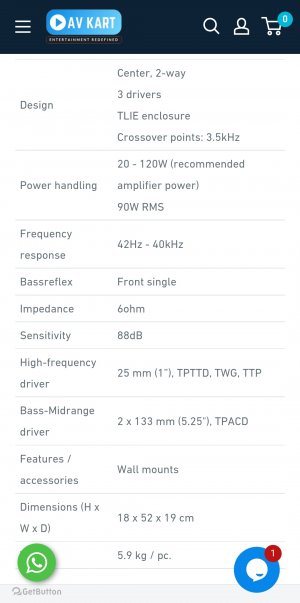

First up, go with whatever Tagas fit your room and choose a good centre. (you said S90C, but I dunno those speakers, but if they are three-way, as most taga centres are, then go ahead)

Platinum S90 Center is 2 way Center speaker. Attached some pics of speaker please do check.Screenshot_2022-11-05-07-22-50-390_com.android.chrome.jpg
