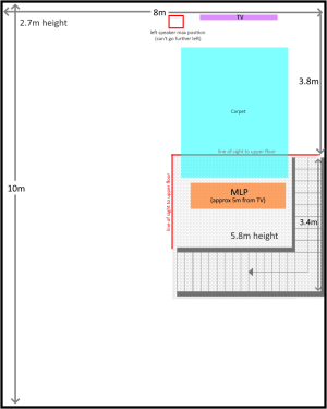

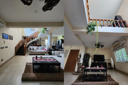

Listening Space:
My house has an open floor plan; the TV room, dining room and kitchen are one big open area with 2.7m/9ft ceilings. The TV area is approximately quarter of the entire space. To complicate things further, the area right above the MLP is open to the second floor with stairs going up, resulting in a ceiling height of over 5.8m/19ft. I have included a very rough floor layout + photos when viewing the MLP from the TV & viewing the TV from the MLP to give a better idea of the room. Excuse the mess in the photos 😬. This is a rented space, so I can't do anything about sound treatment short of the carpet I already have.
I'm 95% sure the size and shape of the space caused me to be unhappy with the soundbar's performance. TBH I was asking a lot from it!
Whew! Quite an exhaustive description of your situation which is a double edged sword - pandemic's over so ain't nobody got time for that!

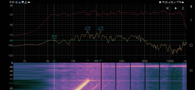

I'm back! After spending some time with my set up, I am impressed with the R900s. I love how they sound for music and they meet my needs completely in that regard. I did a very unscientific frequency sweep and measured it on my phone using Spectroid. dB drop-off only starts below 40hz which is very much in line with the on-paper specs!
(ignore yellow line)
This has resulted in decent performance in movies as well...but it could use a bit more in action flicks. Yes, yes, you all called it!
