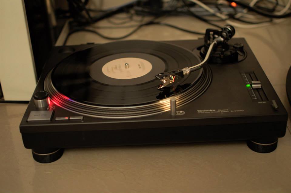

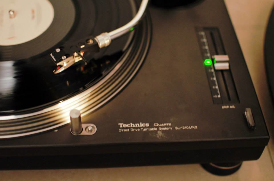

I recently plunged head down into the grooves. Took a SL-1200MK4, rarely available and sold only in Japan. Its a 100V unit and meant for audiophile followers of SL-1200MK2. Now I realise what I missed so far when playing CD, SACD, Blu-Ray Audio - the realisation of being closest to the performance. For this I had to come a full circle. I missed the generation which developed this but I don't want to miss this time, the rebirth of true Hi-Fi. Lucky to be in the "Back to Black" era.
What cartridge is that?
And where did you buy the turntable from?
