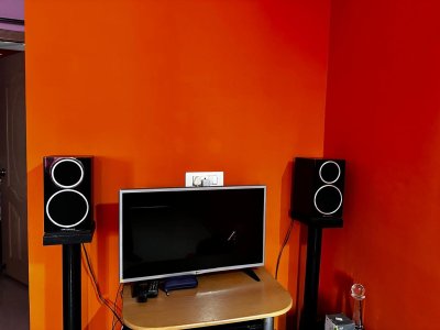

Sure will try the cables first.. Not an expert to explain the issues ☺️, I feel it miss mid frequency and punch of high. Like a bit distorted when listening close..
You just mentioned your speaker, amplifier and speaker cable in multiple replies. Please elaborate your entire chain including source, DAC ( if any), interconnect, digital cable ( if any) and more over room size. Is it a living/bed room or a dedicated room?. These info will help members give you better suggestion. For your information amazon basic cable ( most of them) are not pure copper, they are copper coated aluminium cables. 2.5 sqmm electrical wires from polycom or similar standard brands will be a safer option here.

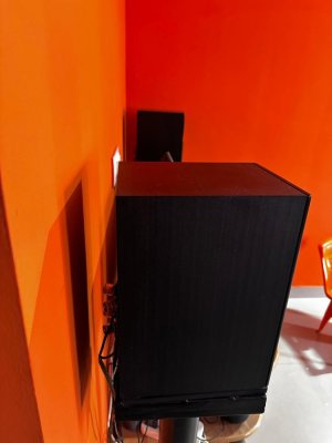

How far are your speakers from the front wall?
“Furthermore, the Diamond 220 exhibits a sense of weight and authority throughout the entire frequency range, which is closely related to its distance from the rear* wall – it is important to maintain an appropriate distance from the wall. If placed too far away, the sense of weight may be diluted, and the bass might become looser, losing its solidity.” - Hifireport
*: What the review calls rear wall is what we call front wall here
Try playing around with this distance and see if you get an improvement. .
Chromecast audio/ Bluetooth tp link> Norge (with 3.5mm to rca cable, amazon basics). > polk audio psw10 inch> Wharfedale (both with amazon basics 14 Guage cable). Using high from amp to sub.
Mostly sub will be powered off for music.
I also have a rasppi with allo piano boss dac.
