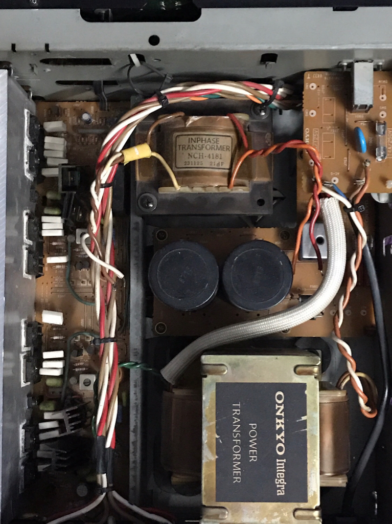

Now, I have a Onkyo Integra 8470 amp which doesn't have a sound output ; the Hyderabad technicians are saying that the sound transformer is defective and needs a replacement, which they're unable to find.
Can anyone guide me to a better technician who'd be able to rectify the issue? Local would be preferred, but I'm not averse to sending it to other metro areas. I love the signature and output of this amp so just don't want to completely give up on it.
It's a solid state amp - the only transformer would be the power transformer. Or am I missing something here ?
Even I thought the same, no its not the power transformer. It is getting on without issues, no sound..
Its slightly small transformer in front of it which is called as "sound transformer" both of the experienced technicians told me the same thing. I will post the pictures once I get it back.

This is the Transformer that is defective - sound Output Transformer at 7'O" clock Position
Pic is from Web ( I will Post detailed Pic Once I get Mine Later)

from the schematic, its an inductor, and from onkyo literature, its called an in phase transformer - its still a power stage transformer
http://www.cieri.net/Documenti/Altri marchi/Onkyo - Circuitazione Real-Phase (1985).pdf
getting a replacement might be tough, perhaps rewind, but this is a custom item, so may not be everyone's cup of tea
Yes its written as Inphase Transformer NCH4181 (231125, 21dF) etc...
How to get one? Can anyone reliable experienced to give it a rewind? What else can be done?
Its pretty bad thing to give up on this amp, I like the clear sound signature a lot.
It might be worth putting up a separate thread on custom transformer winding/rewinding to get the interest of diy folks who might have an idea
