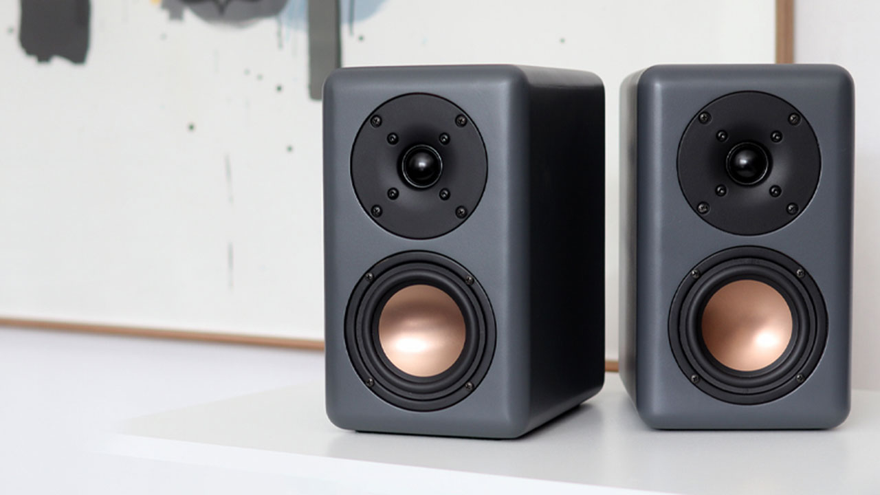

My old cheap desktop speakers died So I was looking for new speakers online and had a thought why don't i just build my Speaker similar to what I did with my pc and keyboard. I didn't realize what I was getting into....
For Start, I am looking to build a compact bookshelf with amplifier that's strictly under budget, I use headphones most of the times so i don't want to spend much on this build so want to build this as cheap as possible but something decent for occasional music listening.
Initially thought of building something like this looks compact and beautiful or These ones but what do I use to power them with?
