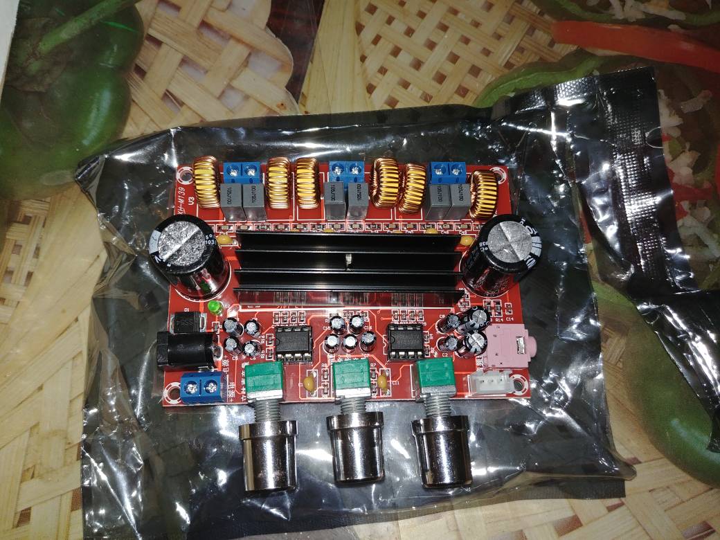

If you look at the blue connectors for outputs, it means you need to strip the speaker wires to appropriate lengths and insert them into the screw terminals and tighten them. Such arrangements are ideal for users who may not be comfortable with a soldering iron.
Power1 and 2 look like they're one and the same. Use either, not both. Ditto for signal input.
The board looks like a single input device. External source selector mechanism will be needed if you need more inputs.

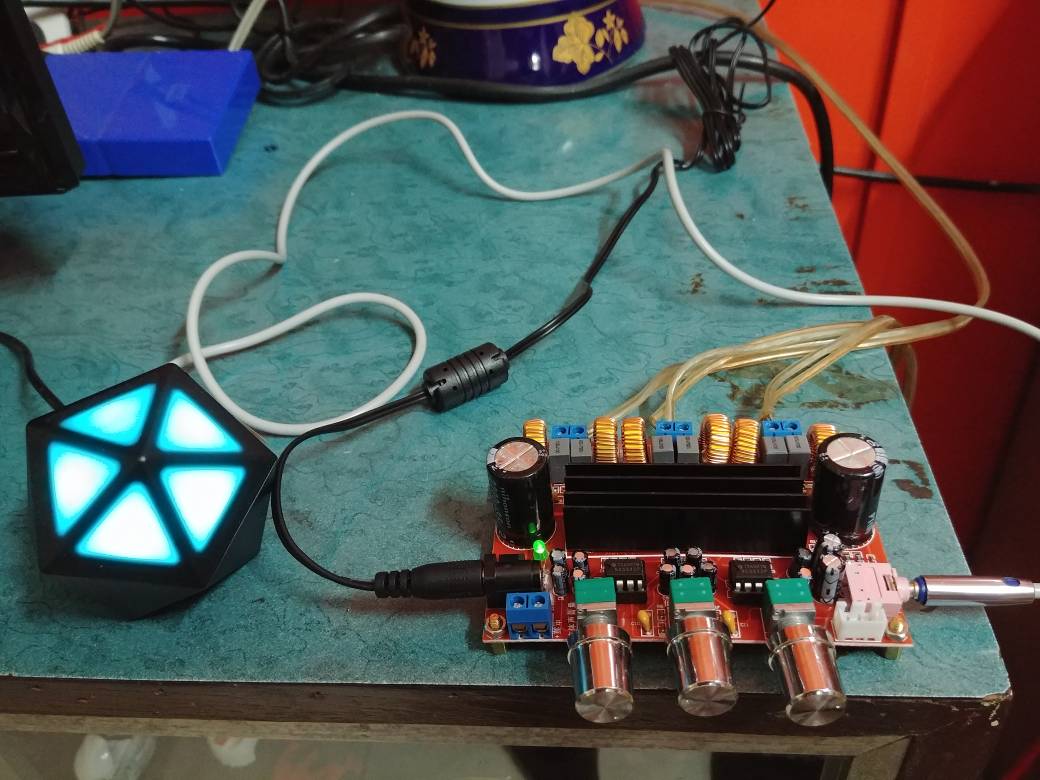

I recieved the board today and connected the speakers as well. When I went to power it on, I realised I have a lenovo laptop adapter which has a flat pin whereas this is a round pin. Can I use a set top box adapter instead? That's 12V and 1.8A. Any particular specs I need to look out for?

Ok so I had a spare Airtel set top box adapter which was 12V and 2A. The plug size was correct so connected it and said I'll try if it works and it works wonderfully! Infact I too thought it would not be powerful enough but it's more than enough! At about 4 o'clock on the dial, it's actually deafeningly loud (played through Xonar DG and foobar). If playing through the Moto Stream on Bluetooth, I can max out the volume to get it at about the same volume which is very very loud and easily fills the room with sound, so I wonder how much louder it will go with a proper laptop adapter!
As for the sound quality, so far I'd say it's as good as the original Edifier amp, if not better. This is superb value for money for just 999! Will it sound even better after running it for a while?

with a 12V adapter, while your satellites will play loud, your sub will be getting only half the power it should
Yup, the ebay AV switchers should be fine
also, bear in mind that at 12V, the amp can push out around 15W per channel (which is twice the rated power for the sattelites, but not enough for the sub which can take upto 30)
at 19V, you get a much healthier 40W. In both scenarios, remember that this amp is a lot more powerful than the speakers, so be careful while turning the volume up, especially on the satellites, which may get damaged if you run them at high volumes too long
also please check if you have connected the plus and minus of the speakers correctly - its very important for proper sound quality
