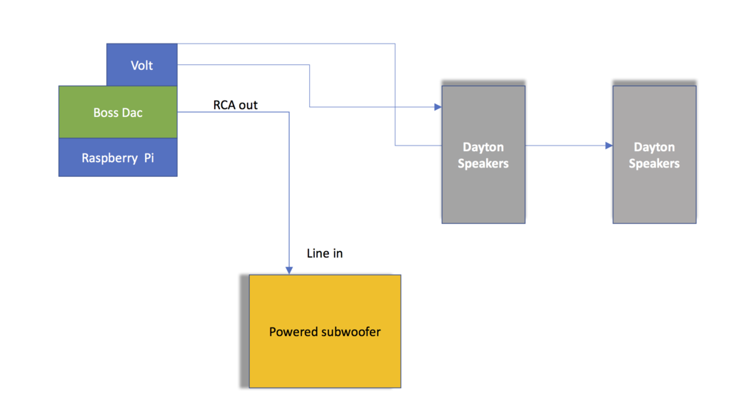

Boss dac does not have a sub out its has only a stereo output
i would suggest you stick with your vana player (with the piano 2.1) and use the raspberry instead of sparky and get a powered subwoofer ( that can easily be had for 15k.
What do i required to connect with allo Boss ? See what i want to do is. I want to connect my dayton audio bookshelf speakers to my Allo Boss, for that purpose what should i use ! I'm really new to audio things. So please suggest me a good music system/audio setup to which i can connect my bookshelf speakers and Then that audio system can be connected to allo Boss DAC.
The order is
Rasberry>>>>BOSS DAC>>>>Volt>>>Dayton
BOSS DAC RCA Out >>>Line in of your powered subwoofer
