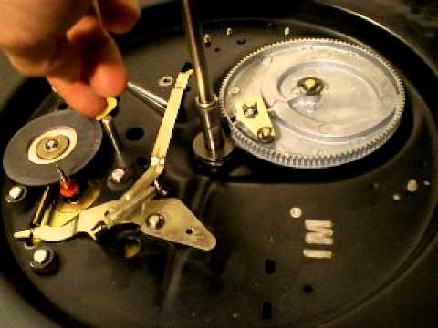

I've got a Garrard 2025TC and it turns on, but moves only at a creep. My first thought was a belt repair, but research (which I started less than an hour ago) suggests no. I'm right now simply trying to find out more about this old family friend. The cabinet is from the 1940's, but the turntable was replaced in the 1960's/early 1970's? It has been well-loved since then, but hasn't had a lot of care. I talked to a repair guy about a year ago and (without seeing it, or having all the details) he was convinced it would be several hundred dollars to repair. Not having several hundred dollars to spend on it, I'm hoping that I can find enough information online to at least consider doing the repairs myself. At worst, I'm back where I started with an unusable turntable.

Repairing a Garrard 2025TC will not be as easy as it sounds as this is a record changer and its a well known fact that Garrard record changers are complex machines. Also these are idler driven and not belt driven. Here's a pic of the idler wheel and mechanicals under the platter.
From what you've said, understand that the platter turns slowly. This can be due to a few reasons. Firstly, turn the table on and using your little finger, try to apply so friction on the turning platter. If it stops almost immediately without any apparent torque, then its a worn idler wheel or the idler wheel tension spring has stretched. The next step would be to carefully remove the platter (the service manual can be downloaded online and it will tell you how to do this) and do the same test on the motor pulley (with the motor turned on). Garrard motors usually have decent torque and hence, you should be able to stop it only with considerable effort. If the motor is not running well, it has to be stripped and cleaned up, lubed and fitted back. If the idler is worn, then it replacing it is the only option. If both the motor and idler are ok, then turn your attention to the platter's bearing assembly and the break mechanism (not sure if the 2025 has this (my RC210 does have a breaking mechanism). You may need to open up and clean the bearing assembly which is definitely not an easy task. Run these prelim checks and let us know what you find.
