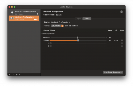

The macbooks play music at a fixed sampling rate regardless of the source. What you need to do is when the song starts playing look at the sampling rate. Then run the application "Audio Midi Setup" application. In this app you can change the sampling rate and change it to match with the source. Brain dead programmers at apple?
On the apple music app, the displayed bitrate ranges from 16-bit 44.1 kHz to 24-bit 192 kHz depending on the song. Is this displayed bitrate accurate? Is there any way for me to check the actual bitrate being transmitted?
What apple music displays is the sampling rate of the source that it has picked up from the server. If you have a dac that displays the sampling rate you will know it. Otherwise if you are running apple music app on a macbook, run the 'Audio Midi Setup' app. It will display the sampling rate of your playback device. See the screenshot below (right now I haven't connected a dac to my macbook pro, but if you do, it will appear in the left pane).
Okay. I had set the sampling rate to maximum thinking that it's an 'upto' kinda situation. I didn't know that it resamples to the selected sample rate. Thanks for explaining.
