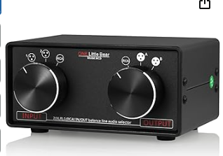

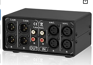

2) The below one has been reviewed on ASR. I'm using this to switch between three dacs (two of them with balanced output and one with unbalanced output)
https://www.amazon.in/gp/product/B07D7P7366/ref=ox_sc_saved_title_1?smid=A3AXGEQKABKICM&psc=1
