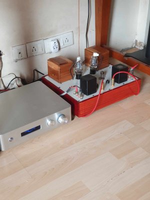

Thanks for the writeup Samir. But a picture under the hood would have been better than 1000 words - for me.
Samir,
What I can see from the images posted are,
- the output tubes are very close to the transformer/ chokes and could affect the tubes negatively Being a wooden enclosure, it cannot block flux lekages
- solid state rectification is used as I don't see any rectifier tubes in the images
Those are Tamura power transformers in well ventilated wooden enclosures.
Chokes are under the chassis.
What’s wrong with SS rectification Hari ? You should listen to this amp for its explosive dynamics… and fluidity.
This amp is a heavenly marriage of all parts as I can summarize it….
Samir,
I had the same concern so i opened and checked and found the transformer is actually not edge to edge inside the wooden cover, there is actually some distance inside the wooden cube.
Nothing wrong. Top end is always tube rectification. I can think of speed as an issue with SS rectification.
Wooden enclosure won't block flux. It should be steel.
It’s actually opposite with speed wrt rectification, so far my own experience tells me. ( I have dismantled as many amps I have made so far. Easy over a couple of dozen in last few years. Of course even his not enough with tubes. They can surprise you anyday ! )
Those Tamura transformers already have good shielding. Wooden enclosure gives them a nice look as I am die hard woody….

Hi @yogibear
Is there a functional reason to put the connectors on the top plate instead of on the wooden chassis? To me this kinda spoils the clean look of the amp.
Also what are those two knobs on the top?
Hi @yogibear
The two knobs are individual volume controls for each channel.
I place the rca input jacks nearest to the volume control knobs and the driver stage tubes.
The speaker output terminals are nearest to the black Hashimoto output transformers.
The layout may not appeal to all but are shortest distance from the point of origin / input and no interference of any kind from power supply lines or among themselves.
I can play a little to make them neater but not much else it will amount to crossing paths with power supply lines and it always shows up in sonics in one way or other.
If you notice the amp from top, it’s fully dual monoblock design and divided in two halves, top and bottom. The top part is power supply part including the power tubes, power socket at top end and lower half which includes signal input and signal output path.
All three paths, never cross each other.
When I sat down to build this amp, my complete focus was on soundness of electrical path underneath the chassis, least or no interference from each other, minimal distortion and maximum sonics from the tubes. And of course a presentable and symmetrical layout on the top.
In my future builds I will try to address the ergonomics on the top, without sacrificing the important aspects underneath.
