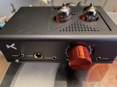

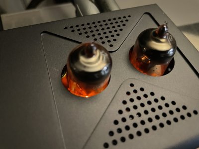

Finally took the plunge and bought the Xduoo MT 602 tube preamp from The Audio Store. Price after discounts was INR 7500. Stock tubes were Chinese which I found to be sightly shrill (high freq). I replaced them with GE 5654 tubes from Agra. After the replacement I got the sound which I wanted- the digital glare is gone. The vocals sound wonderful without any over emphasis on any particular frequency. The sound stage is really decent with very good separation. Initially when listening to old Hindi film songs the sound used to be centred in the middle between the speakers but now even for older songs I can clearly place the instruments from left to right with vocals at dead centre. My chain is iPhone (apple hi res) >> audioquest dragonfly dac >> Xduoo >> Rotel RA10 >> Micca RB42. Would highly recommend to those looking to take the plunge into tubes without breaking the bank.
