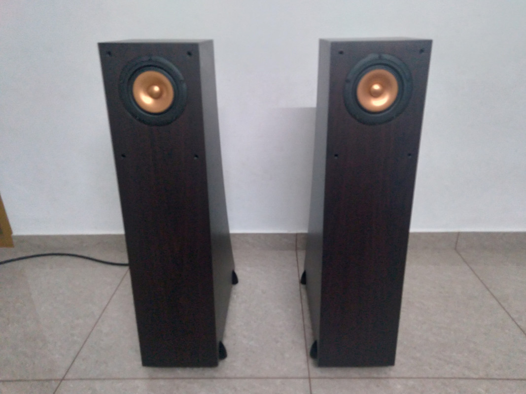

This is a review of Pensil 11 with Alpair 11ms. It's based on untreated room measurements taken using MiniDsp UMIK-1 and REW software. so measurements will vary from my listening room to yours.room.jpg
BUILD
So let's start from the build itself. The cabinets were build using 18mm baltic birch ply in Abudhabi. I sourced the plywood myself and hired a carpenter to cut and join. The entire process probably took like 3-4hours and the cabinets were ready. I opted for the native finish of birch ply and did not put any veneer, polish, or vinyl coating. So overall i would rate this cabinet as EASY to build as there are no angles or curves involved. The cut pieces were joined using nailgun and fevicol and finished with putty on all joints to enhance sealing. If you have a table saw you can cut and join these pieces yourselves.
The stuffing was done myself using polyfill used for sofa (less springy and slightly higher mass than pillow fill) and thick jute felt is lined only around the vicinity of the driver on opposite sides to reduce early reflections.
I've used around 400g of Polyfill per cabinet.
After mounting the drivers and running them in for a few days I started measuring and assessing the speakers.out cab.jpg
