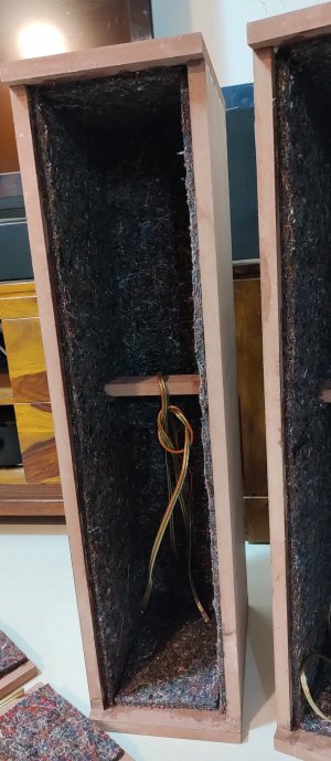

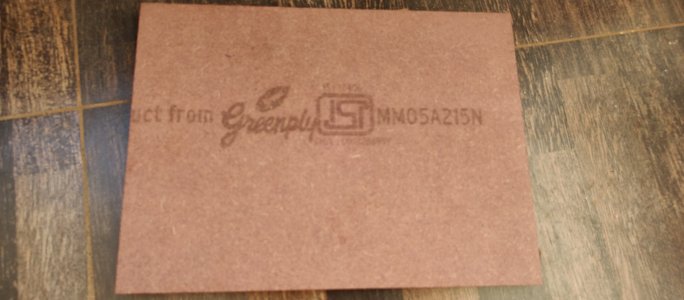

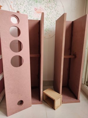

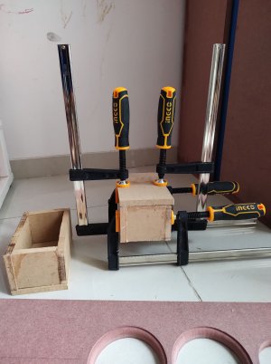

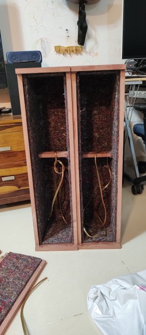

Just want to share build progress of my new 3 way mini tower using below drivers
2 x ND105-8 (in parallel)
1 x TC8FD05-4
1 x XT5SC90

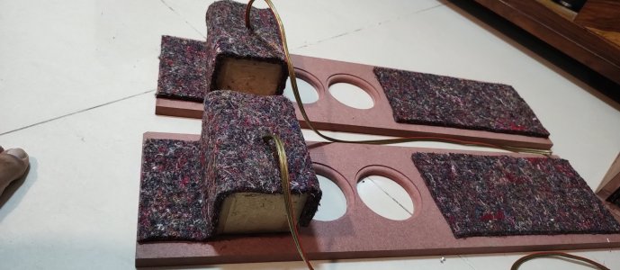

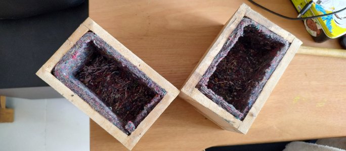

Total Cabinet volume is close to 27 liters, sealed mid chamber takes 1.2 liter out of total volume.
Planning to tune it around 42hz.

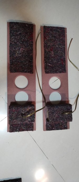

Damped with 10mm acoustic eco felt. Will add some recron pillow fiber to sealed mid chamber.

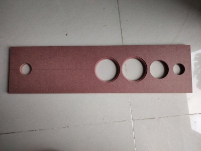

All drivers will be front mounted, rear edge of ND105 is rounded just to make room for air movement.

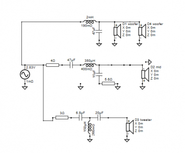

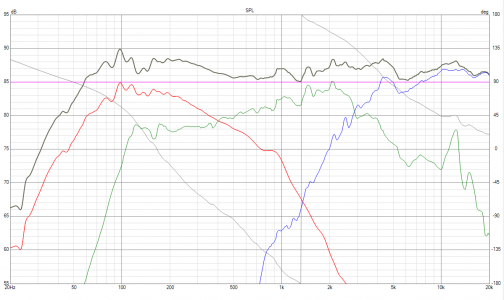

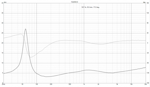

Crossover -
FRD files for Dayton ND105 was available online,
Generated FRD files for mid and tweeter using FPGraphTracer
Crossover simulation done using VituixCad2

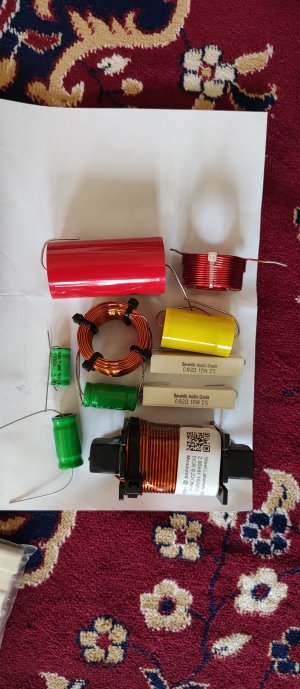

Decided to place crossover outside the box.
Crossover Simulation files attached
