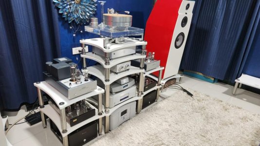

So that's my 2 cents there 😜😜.... Maybe the talk of time alignment has ruffled a lot of feathers, And as I mentioned before, and as is there in my signature below, iam mostly too dumb to talk scientific knowledge. But iam over the moon with everything built by hari sir, Yes including the cabling too😝
We can debate endlessly based on theory, but listening is where it. matters.
And that's my blissful sounding setup below 😍😍
View attachment 73153View attachment 73153

Hari, when you did measurements, were you using that same heavy duty shelf, under each speaker - raising it off the floor ? .............. I bet not.
If not, I would say that the speaker's present elevation - off the floor as existing now .......... is compromising overall performance, particularly now on the bottom end..
Bass is omnidirectional, and when elevating the speakers' bottoms off the floor, one is allowing the bass frequencies to NOT project forward into the room - and with full and " on-time " energy.
When the speakers were positioned ON the floor, bass energies will travel in a continuuim. It would proceed down the front of the baffle, and take a ninety degree turn, out into the room, moving towards the listener's seated position.
As it is pictured and positioned now, the omnidirectional bass wave tucks down UNDER the bottom of the stand, between the enclosure's bottom, the stand, and the floor, into that user-generated void. Each stand's void haphazardly disperses omnidirectional bass energy to the room's rear walls and side walls, in an out-of-time manner - and with a diffuse fashion.
Bass reflection times from surrounding room walls confuse the presentation, and it slightly loses some of the originally-recording's bass energy and focus.
It is not easy to optimize this aspect of room set up. But one can try !
Someone like Prem can tell you much about positioning. My purpose in posting today is to point out this " stand " problem, at least as I as I view and experience it. Perhaps the speaker's owner may get into the " mood " one day ( ......... or over a few weeks or so ) and see if they can effect a placement difference to improve that lovely red and white creation - even more so.

Hello sir :)
Thought Id just share that the measurements when designing the crossover were done without the current speaker plinth they are presently placed on. The speakers came with spikes to sit directly on the floor. And if my memory serves me right, the measurements were done in the axis of the mid range driver. My subsequent lifting of the speakers, has not shifted the tonal balance in any way that i can notice. And infact, Iam preferring them with the mid range driver almost at ear height or maybe just a little above. But the added height to the sound stage with the present arrangement is very enjoyable. I think i got carried away in treating my room, and might have just gone a bit over board. Thus, the addition of super tweeters has added more liveliness to the sound i think. All in all, Iam very pleased.
Coming to the bass, i had big bass issues with bloated bass and reverb prior treating my room. But that existed even before and after using the plinths. The bass treatment in the room, solved that issue to a very large extent. And i cannot perceive any issues with bass at the moment. But yes in theory it is not ideal to shift the height of the bass driver, and also to add a intervening solid layer of reflecting material between the driver and the floor. But there are no audible effects that I can perceive :)
