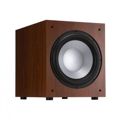

Thank you for the reply. How is Yamaha NS SW300 sub? Specs looks nice to me and it is within my budget as I am getting it pre-owned.
NSW300 ia a very good product at this price point. But Jamo J10/J12 are also good propositions.
NSW300 ia a very good product at this price point. But Jamo J10/J11 are also good propositions.

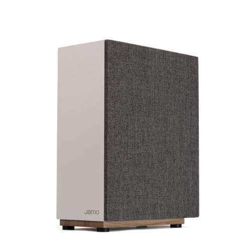

I am getting pre-owned deals for the following two subs:
Jamo sub300
Tannoy Ts2.8
Are they any good?
Tannoy 2.8 seems to be a little underpowered and Jamo S300 is a fairly old model. If possible, audition both of them to see if the bass is sufficient for them and the physical condition.
