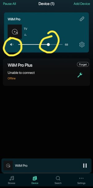

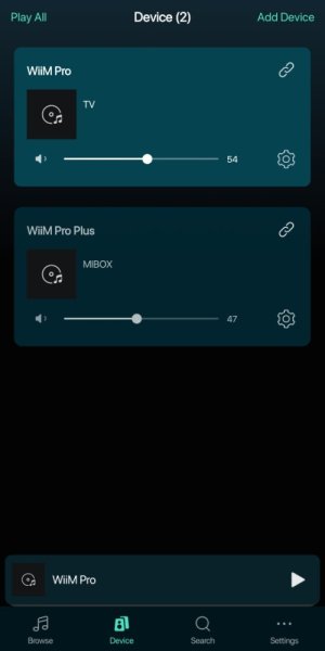

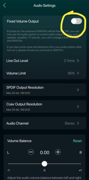

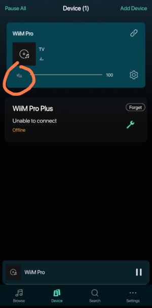

Guys, need some input on Wiim Pro/Pro plus. If I add in a DAC and connect it to a Fosi Audio V3 and keep the volume constant, can I control the Wiim (which would be connected with a optical/coaxial to the DAC) streamer's volume from the device itself?
Yes u can control the volume in Wiim Pro and Pro plus .
Wiim Pro and Pro plus having volume control option in app itself which u can enable or disable ( Full Volume ).
I'm not talking about bit perfect something which use to crop up for such configuration in the forum.
Image attached for your reference with volume control and fixed volume ( Max out ) for selected optical in ( to Wiim pro )and optical out to IA.
Hope this helps.
