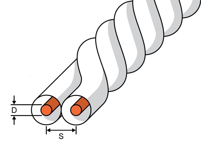

I make my own cables using cat6 twisted pair. It even beats Mogami 2549 with Eichmann Bullet plugs.
There is nothing vodoo about cables as many would want you to believe (cable manufacturers and those who have spent good money on them). Cable manufacturers will give various reasons, some going to extremes like triboelectric charge, time smearing, copper oxide turning into diodes, skin effect and what not. But let me stop here else it will become an all out war.
You want to transport a complex signal from the source to the destination. The ideal cable would with 0 Ohms resistance, 0 Henry Inductance and 0 Farad capacitance.
You can easily make cables with extremely negligible resistance, inductance. But it is very difficult to make cables with very low capacitance. The moment you bring two conductors near each other, the capacitance increases.
Most commerical interconnects give you capacitance ranging from 60 pF (pico farads) to around 100 pF per meter. The cheap ones that you get free with Tata Sky set top box gave me around 300 pF. Now this creates a problem for high frequency. e.g. use this to calculate the impedance
For 15 kHz a 100 pF capacitor will apply a load of 100 kilo ohms and for 1000 Hz it will provide a load of 1.5 mega ohms and hence make the response of the amp non-linear across the audio spectrum.
