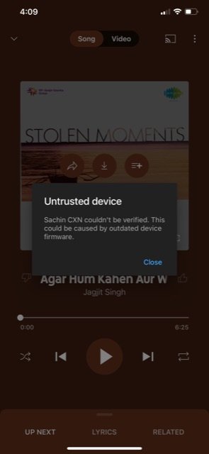

I tried cross-checking this with YouTube Music to check if it’s Spotify specific or CXN specific issue.
Earlier from YT Music on my iPhone I could select to cast it to CXN, so it then played natively. I didn’t have to select the AirPlay option. Now when I tried it, it doesn’t allow. Here’s the error message I get:
Note that my CXN’s firmware is updated. So most likely the recent updates have broken the casting & native streaming in more ways than one.
