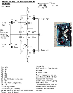

A ceramic pickup is a basically a capacitance and so if you don't load it with a very high impedance ( in Mega Ohms) it will have less bass. Tube input preamps are ideal for this. But you do have FET input opamps that can also be used.
My memory from a long time ago is that for this application a tube input sounds best. However I only recall seeing input impedances of around 1 Meg Ohm. You can't arbitrarily increase the input resistor of a Tube stage. Typically for small signal tubes like the ECC series you could go up to about 2.2 Meg Ohms. Of course with NFB the equivalent input Z can be made much higher.
Here you will find an opamp based one with 10Meg input impedance. However I'd bet a tube stage would sound better ! Not sure about modern FET input opamps. You will have to try them out.

There is an easy way to work around the limitations of Input Impedance of a tube amplification stage used with a ceramic cartridge.
A Ceramic cartridge (loaded by 2.2 Meg Ohms +) provides a relatively high output voltage of 300 mV to 500 mV.
This high Voltage can be used .... indirectly ... to create a much higher load on the ceramic cartridge.
As an example, consider that the input impedance of yr phono stage is 1 Meg Ohms. Insert 4 Megs ( 1Meg x 4 Nos) Series resistors between the Cartridge & the Input of the ceramic phono stage.
The effective impedance seen by the ceramic cartridge will be 5 Meg Ohms !
The Ceramic Phono stage will receive only 1/4 th the cartridge output voltage
ie 300 mV/4 = 75 mV
or 500mV/4 = 125 mV...
still plenty for the ceramic phono stage....
