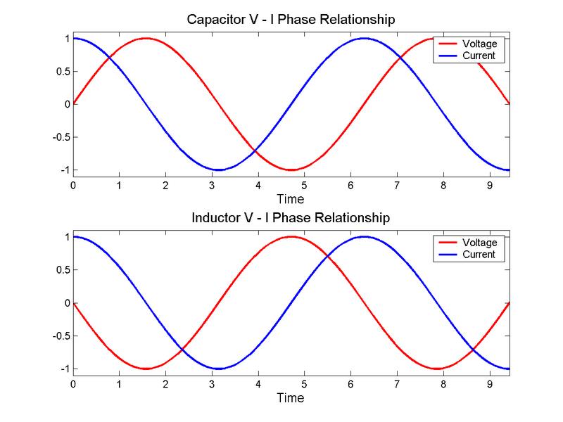

Layman question: My amp is 140 wpc, and also has peak current supply of 11 amps a channel. Don't the two go together - will there be another 140wpc amp, that does not supply the same current level if needed to? Assuming both amps are honestly specced.
Its not the peak current only which is needed to drive the reactive energy system comprised of Lossy Passive XO + drivers , what we call as speakers. The impedance is not resistive in nature its reactive means the peak current demand is not linear with voltage, rather it has phase angle at which it is being drawn from the amplifier, it could be 30degree or 45 degrees.
Under those conditions the amplifier will have zero crossing at voltage at output but the current flowing through it can be as high as 10 amperes. Which can put great stress on the output devices and considerable heat generation occurs in linear class-A/AB amplifiers. Class-D amplifiers are immune to this, they recycle the reactive energy back to power supply hence are fun to play with.
So 2 different amplifiers with same rated wattage cannot be same unless designed on similar lines by taking consideration of reactive current.
See the pic, current and voltage waveforms are not following each other, they are PHASE SHIFTED due to presense of reactive elements[capacitors & Inductors] in the path of current.
