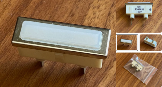

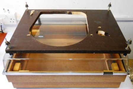

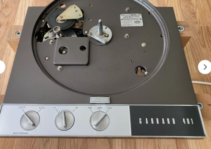

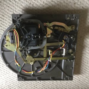

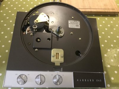

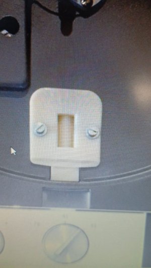

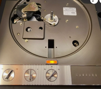

Hey guys, I've attached three pictures for reference. The first two show the top plate—it's pretty clear there's an empty groove in one of them, just above the strobe light. The third picture includes the part that's missing. This has been nagging me for days, and I can't seem to figure out what it is, anyone?
p.s. i just noticed the thickness of this top plate in the on with groove seems thicker?
this white part goes in the empty, rectagular groove above the strobe in one picture,
About a decade and a half ago when I was into Garrard 301 and 401 hunting in the UK, I came across this scenario while checking out some new old stock Garrards at a very knowledgeable audiophile's home. His explanation was as follows:
1) the early 401s had a flush strobe like this one, notice the difference on the underside with the mirror:
2) the later 401 chassis were designed for a raised strobe with a chrome frame, which was a lot simpler, design wise
Here is a closeup of the newer strobe light with a chrome frame:
The advice given to me was Garrard decided to drop the flush strobe light and use the newer raised strobe even as they still had the chassis types (top plate) cut for the older flush strobe, in stock. Hence they just went ahead and bolted the new raised strobe light on-to the old chassis, leaving the original mounting cut-out, open. Quite a few of these came out of the factory until the older chassis stock ran out and Garrard of course switched production to the chassis specifically designed for the newer raised strobe light. What you have is apparently this 'transition-chassis'
And the strobe on the very early flush strobe 401 would not be on all the time along with the motor. The pitch control knob had to be pressed down to switch on the strobe.
This is a great point, many first-time users of the oldest version always come back saying the strobe light is not working. The oldest production series of the 401 came with twin spark suppressor capacitors (these also happen to be the most desirable) and a switchable strobe. The strobe light switch was actually integrated with the pitch control and would light up only when pitch control was pressed and held down. The production series that followed (and continued thereafter) featured a single spark suppressor capacitor and without the strobe light switch (the strobe light stayed on from power-up). There is also this raging debate on the aesthetics angle as not too many are familiar with the switchable strobe light concept on the older model- not too nice for someone to drop by your home to listen and ask whether the strobe light has fused :)

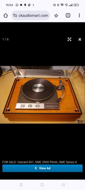

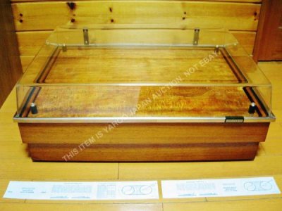

didn't know that 401 came with a suspended plinth too, SME plinth apparently, instead of the squash balls, springs on all four corners....It's obviously not favoured. We can now see how the squash balls were considered as an option.. @reubensm any insights...
Interesting to see how suspended plinths were a thing back then

Garrard sold both the 301and 401 with mounting hardware that had springs. The 301 came with stainless steel bolts that are visible from the top and fix it to the mounting board. The 401 has studs that go up from bellow. Both sets had four springs and threaded posts to be fixed at the corners of the mounting board which would then drop into the plinth or console.
In 2008/9 my 301/3012 came in a huge 6' long custom radiogram of 1964 vintage where the 301 was mounted in such a fashion under a flip up top.
Thanks for insights! Looking back, loricraft simply replaced the spring with squash balls, innovative, and in some way still true to the original design....
BOTH 301/401 original SME were suspended plinth. fundamentally they are the same but for a different powered motor and shape of top plate.
I dont think springs are great (dont have direct experience) but sorbothane, squash balls etc all work very well .They do not as sound good with a heavy plinth which works excellently for a lenco.
The SME 2000 plinth was essentially a universal plinth and not really a Garrard-specific one. Vintage literature of those times suggest that the SME 2000 plinth was actually designed by SME for their flagship 3009 and 3012 tonearms. The user could just get the mounting board cut to the template of the turntable deck and the SME tonearm that he/she owned and bolt them on. The dealers who sold them either assisted with cutting the mounting hole or just had prefabricated mounting boards for various type of decks and SME tonearms. One would notice a lot of Garrard 401s paired with them as they were sold at a time when the 401 was in production.
Here is an example of how the original brand new one looked:
There are a lot of examples of the SME 2000 in use with other decks, especially the Thorens TD125. I have never owned a SME 2000 but came across a few of them, and actually heard one with a Garrard 301 and SME 3012, at an esteemed FM's home. It sounded great but I remember looking at it and thinking that a Garrard deck on it would need special attention to keep it running in pristine condition, to avoid rumble.
