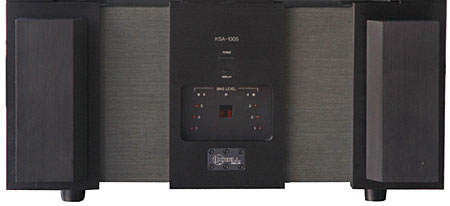

here s a Krell Class A amp..even this is not a pure Class A as it is biased to usually 80% at Class A and the rest being Class B

Anyway this is a wrong Amp to compare on Class A as the real krells were those of the old. the 300x itself was considered a step down and the 400 a deviation from what krell stood for. Those KSA series are legendary.
