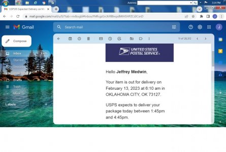

* My personal-use audio speakers arrive at GPA today, for a re-design / rebuild to provide duplex / single point source capability, if I so choose.

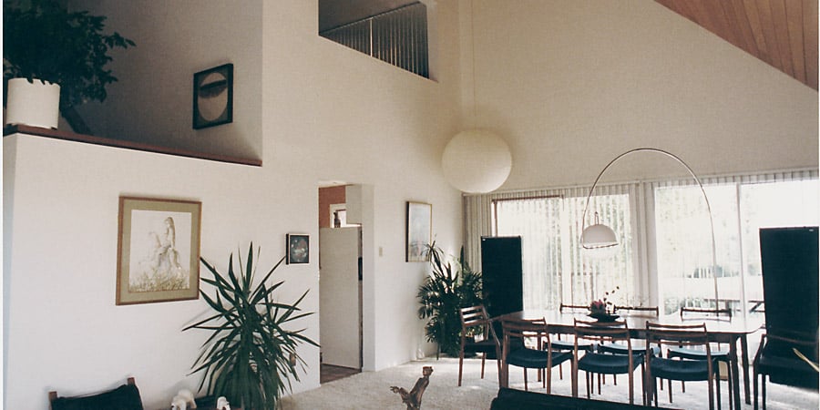

My understanding is one should get good depth with a very large room. The distances are large enough for reflections to cause havoc with our perception of the sound.
The question is if it is possible to get good depth with rooms of size of around 400 to 600 sq ft. Left and right perception easily happens even with crappy boomboxes. But with such small rooms is it possible for the sound to appear beyond the walls? I have never experienced that and to me that limits the quality of stereo. Would be very interested to know if this is possible either by means of good setup, sound treatment of combination of both.

Most critical for imaging, stage, depth, width etc in a stereo setup is for both speakers to be in phase in design.
Next the room and speaker positioning plays a critical role.
The more you draw out the speakers out from the boundaries, the better the perception of depth and width and height. Avoid the distance to side and rear walls to being equal if the room allows for such placement.
With smaller rooms best solution is near field listening. Also avoid listening position in the middle of the room or too close to the back wall.
I have a feeling that this is so dependent on the width of the room and the distance of the speaker from the wall and the brain getting fooled not fooled by illusion. I get more width when i close my eyes. I'm not convinced by the height. Depth somehow never goes beyond the wall which you are facing (even with eyes closed). Will follow your post as you are a doctor and hence mostly a logical person. So if you achieve this, I know I will have to make changes to my system to achieve depth.
I too have a feeling that’s Room acoustics and speaker placement is sure to play a vital part in creating the sound stage illusion, as much as the set up and the recording as you, @sound1 and @Kannan have shared.
