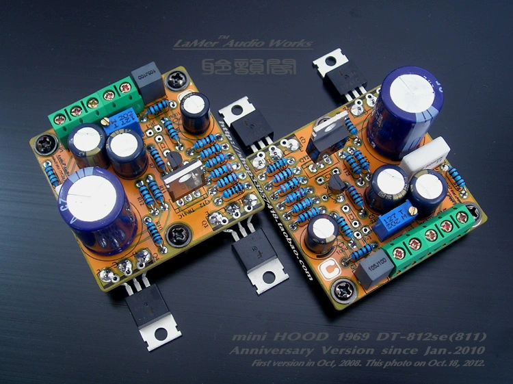

You are right captain. Here is 10w JLH from La mer of DIYaudio.
WOW find my this photo by google :yahoo:

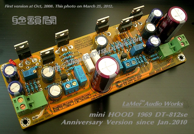

I also have 2 verions of 3W JLH1969 too as following picture :yahoo:
