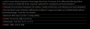

What am I missing? ..... below are specs from the manufacturers website for both Rontek and Niagara 1200.. while Niagara claims to be doing something...Rontek on the other hand comes across as an expensive surge protector, there are no specs for ac filtering?
you are paying monies for ?

Thats Interesting specs for the Niagara. I see below for the Rontek AviRON-HT
✓ Rack Mountable Power Distribution unit
✓ Sequenced & Isolated Output Banks
✓ 3+ Level Filtration and Clean up of Power for Un-compromised Sound & Picture Quality
✓ Complete protection against catastrophic voltage, spikes and surges
✓ Multi-Information Backlit Display
✓ Sequenced outlet banks - 2 Banks | 7 Universal Sockets | 1 Unswitched
✓ UN-COMPROMISED SOUND and PICTURE QUALITY
Level 3+ Power Cleaning and filtration eliminates common elements of contaminated power.
This ensures delivery of un-compromised quality through advanced power purification
✓ MONITORS, INDICATES and PROTECTS
The Automatic Voltage Monitoring Circuitry continuously monitors incoming power as displayed
on the LED/LCD display. In case of voltage drop or over voltage situations, power supply to the
equipment is automatically cut off. When the voltage is normalised, power to the equipment is
automatically restored.
✓ EARTH FAULT DETECTION
A good earth is a must for dissipation of noise, transients and surges. AViRON continually
monitors for ground fault conditions and notifies you through a beep and an LED indication if
there is an earth fault.
✓ REDUCES CROSS-CONTAMINATION BETWEEN COMPONENTS
AViRON is designed to provide noise isolation between two isolated outlet banks. Also featured
in are two high current outlets to ensure consistent peak operation between components
regardless of load conditions, answering the challenge of corrupted power line
