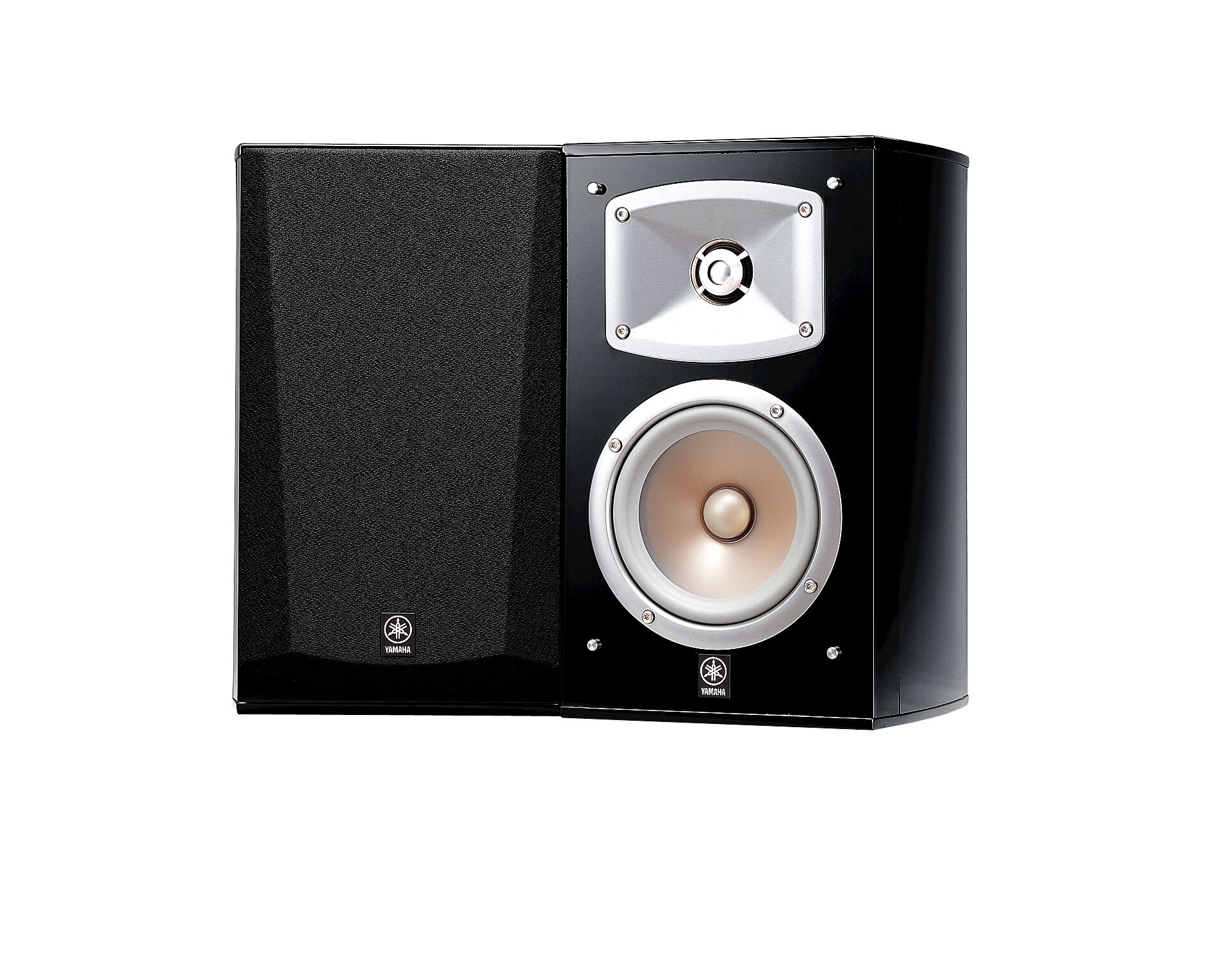

Could anyone confirm if my speaker shortlists are compatible with my avr? Am I missing any other major recommended option in this price range and also compatible with the 3072?
Not sure on the pricing....you can also check on Dali Zensor series (if available) or Specktor....also look at Polk Rti A1 or A3 series.....
Dalis are known to pack a good punch.....Polk Rti series is known for a good playback balance for music and movies....I used a pair for almost 8 months....(I tend to have a habit of experimenting on different brands and models ...just to get an experience).
If you are looking to strictly follow your own listing.....then I would consider between the Yamaha NS333 and the QAcoustics 3020i

If you are a bit skeptical on the investment and whether it will pay off in proper playback...suggest then you get the Yamaha bookshelf speakers which will pair well as per specs and definitely sound much more better n refined than the original speakers that came along with the AVR. Yamaha with Yamaha will not go wrong for sure!
You already have an active subwoofer to take care of the low frequencies. You can read reviews or first hand information in the Yamaha Owners thread... https://www.hifivision.com/threads/yamaha-avr-owners-thread.21982/
Browse through the pages as the thread is loaded with information which can be useful for you in decision making or tweaking your own AVR for optimal use.
