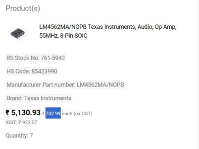

Theres one more update.The opamps were replaced with the LM4562.I feel it may have made the Marantz sound a bit too analytical for my taste.
It seems the instruments are taking the front seat and the voice kind of gets recessed unless we are in sound direct mode. The warm sound of marantz is gone and its like more of now in the Yamaha territory when coupled with the polk speakers.

Well he suggested them and said that if i choose to he can remove them.He said the sound would be more open and analytical.Although later hearing the price of the op-amps he infact forced me not to change it but i had already been bitten by the audio bug.I was hell bent on listening to the change in sound.But it seems i should have stayed with the marantz op-amps it seems.Only if we cud travel back in time.

I sourced the op-amp myself from RS components and delivered it to him.7 op-amps cost me 5130Rs(each 732 rs).Am not sure if what RS components sold me is fake.RS.jpg
I sourced the op-amp myself from RS components and delivered it to him.7 op-amps cost me 5130Rs(each 732 rs).Am not sure if what RS components sold me is fake.View attachment 88334
No. That will not be fake as RS is a trustworthy site. It would cost that much since you are not buying in bulk. Try to get the original op-amp
