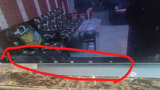

Blisters seem to have a pattern. They rise up every 7-10 cms horizontally across the edge of the panel. Hence I suspected a chain reaction of connection cable being shorted. Having read through other LG customer service stories where things did not get fixed after panel was changed, I wanted them to inspect as they are going to anyways open up the TV for fixing panel.

Uploaded the pics just in case anybody is curious about the blisters.
@moderators - is it possible to edit my original post to include this pic?
