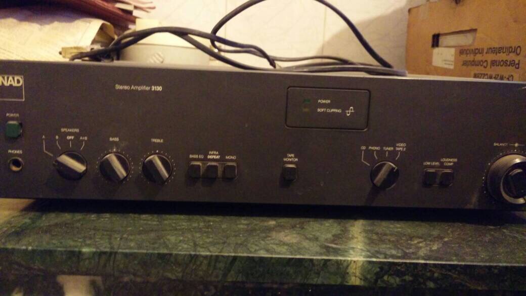

Hello Malvai, I think you got the model number wrong. Is it the 3120? Like the one in the pic below?
What are the symptoms?
I'll check the model no again, once I go to my dads house... have it in my room there... you may be right though...
One channel isn't working... was thinking that I should update all the electrolytics... in both channels...
I would say take a shot at it with contact cleaner first
