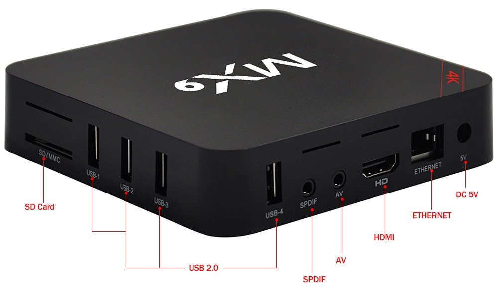

AVR though have USB input, it is limited to digital audio playblack only (MP3/FLAC/WAV) formats.. They don't have video decoding capability..
The least expensive device that can play all (most) audio & video formats is an Android TV Box.. There are many models aval on amazon.in (or) ebay.in for <=3K.. They support playback from pendrive / Hard disk too.. So, you will need to consider this device too in addition to your entertainment system..
Pick one that has more than 2 USB ports, 2GB RAM & 16 GB ROM.. Android 7.0 is the OS on most Android TV Boxes..
Some examples - https://www.amazon.in/Movo-MXQPRO-G...id=1528779314&sr=8-11&keywords=android+tv+box
Other members have provided various options for HTIB / AVR + Speakers.. Choose the one that suits your budget..
