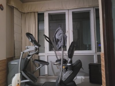

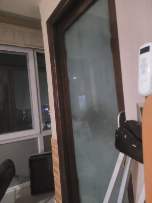

*Can't do much about the room. Have attached pictures of the tv unit. Room is probably 12 x 12 x 11 (height). Balcony wall has been removed and replaced with UPVC and glass. The wall behind my listening position is paneled with teak plywood. It also has a wooden door with a glass panel (bathroom) - can be seen in the picture.View attachment 87341

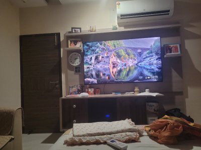

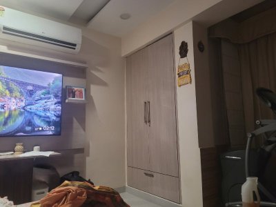

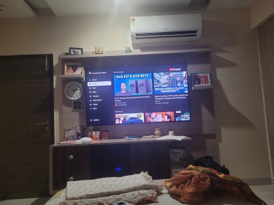

Thank you. I could not see the Marantz amplifier on their website. Seems to have been discontinued. Fiddling isn't my cup of tea, and am willing to pay for the machine to do it on my behalf, or temper my ambitions a little 😀 By the way, I do not have space for stands either. I think the speakers will have to be on the TV unit (pictures attached). A carpenter fabricated this for me and it is really solid - we tested it with two people jumping up and down on it!

Also you will need to lift the speakers from your cabinet using some isolation. Or the cabinet will sing along and also affect dispersion characteristics of the speaker negating anything you do with room correction. Bigger elephant in the room is the placement of speaker on cabinet directly.
Iso acoustics aperta is a decent solution.

What is your expectation for this system in terms of performance? DSP / RC helps when one runs into trouble with frequency balance and sound stage due to loudspeaker placement constraints. You obviously have placement constraints. Adjoining wall distances are also important . Maybe it will improve with dsp but I am not sure how much. I have not played around with dsp.
You just hit the nail on its head. I am hoping opting for RC/DSP will help improve the sound quality despite all the constraints with speaker placement, room acoustics etc.
