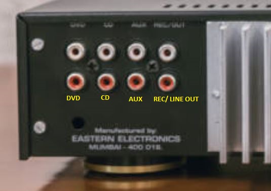

Norge 2000 back-panel connection ports:
1. Going by the fact that the Norge has 4 inputs - DVD, CD, AUX and Line Out which one do I use to connect the stereo cable coming from the PC to?
You can connect to any of DVD, CD or AUX (not Line Out). I have the same amp and connect different sources to these 3 inputs, and interchanging among them does not make any difference.
Make a note that line out is not pre out. You can connect subwoofer but cant control its level with Norge remote.You need to adjust subwooer volume every time when you change Norge amps volume.
