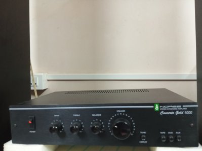

Norge Concerto Gold 1000 Review ( An underestimated Brand)
I tried everything with norge. It lacks low volume bass for sure. Even I paired with Akai vitage book shelves with 10inch woofers but the bass goes down along with the volume. The circuit design itself is such its made keeping in mind the mid frequency particularly voice, so it lacks depth in low volume. A loudness on/off option might have solved the issue. Its the current which drive the heavier coil of woofer while reducing the volume along with the voltage the current also drop. Here the loudness circuit comes in handy holding the current from dropping.

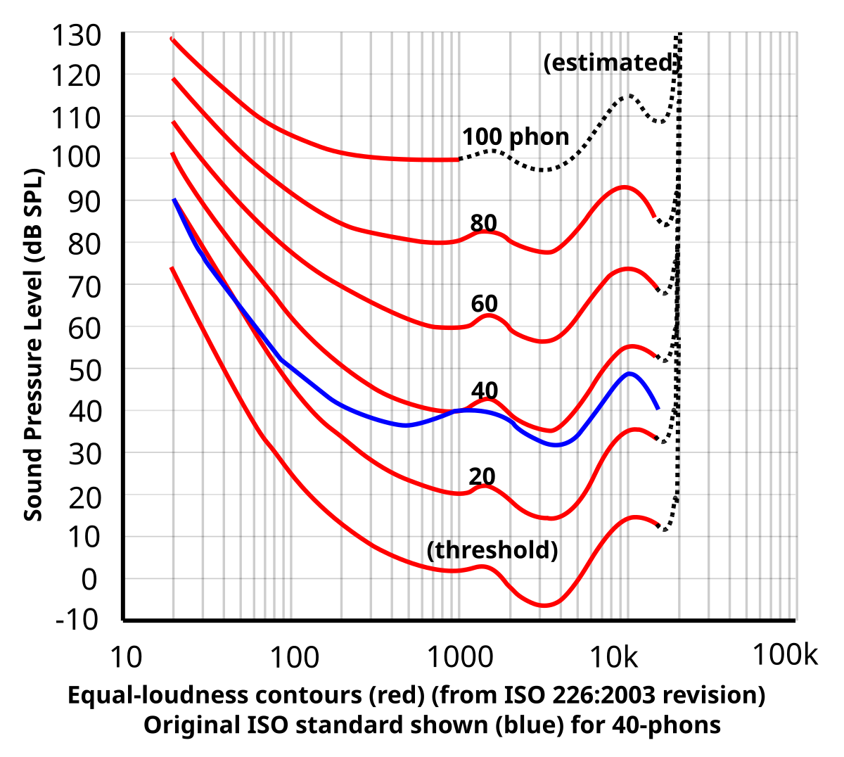

Bass IS supposed to weaken at low volumes. This is how our ears work.
If the purpose of loudness on/off button is to increase the bass frequencies then it is quite wrong, because I can easily increase the bass using the equalizer knob for at least ±6 dB on Norge amps.
Loudness on/off button will not really solve this issue, please see the reason below.
Every thing is fine with Norge except one drawback they are not providing Loudness on/off option. Which is a must for listening in low volume. This provide low frequency boost with a nice thump. I spoke to Mr Laxman he bluntly said no way😀.
First of all, we all need to be aware of something called as Equal loudness.
Simply speaking what it means is that ear is extra sensitive to 2-5 kHz spectrum and thus even at lowest volume we are able to hear these.
And the ear is low sensitive to <1000 Hz and decreasing sensitivity with decreasing frequency.
So, in order to actually do loudness equalization one should have a very wide bandwidth low frequency boost that starts at 20 Hz and ends at 1000 Hz. High frequencies are not at all to be touched since whether it is low volume or high volume the responsiveness of ear doesn't change.
Most of the loudness buttons boost bass as well as treble and again, it is plain WRONG.
To use some numbers, what this means is that lets fix 80 dB/1000 Hz as the desired volume; which makes it 80 phons loudness. On this contour we see that the ears need 120dB at 20 Hz to experience the same loudness.
Now let's view the scenario at low volume say 40dB/1000 Hz = 40 phons loudness. On this contour, we can see that the ears need 100 dB at 20 Hz to feel the same loudness.
What this means is that the ear loses around 20 dB additionally at 20 Hz when we reduce the amp output by 40 dB, in other words 40 dB loss due to reduction in volume, and 20 dB loss due to reduction in sensitivity.
Now we can construct the loudness boost curve, for a 40 dB reduction in sound volume, we must boost all frequencies from 20 Hz to 1000 Hz, starting with 20 dB at 20 Hz and reducing to 0 dB at 1000 Hz (that means boosting bass as well as lower mids, and mids also to some extent).
Tell me how many "loudness on/off buttons" have you seen doing this?

Purchased Norge on July 01st 2024 from Hammersmith Estate . Laxman who has been with Norge for a long time gave a good demo of all the amps . Norge 2060 , Norge Mosfet 2000 and Concerto Gold 1000 paired with Norge Bookshelves and Floor standers .
I liked the Concerto Gold 1000 for the balanced sound in all the frequencies . Norge 2000 was more on the laidback/warm side.
Listening to it with Marantz CD6005 and old CD5001 paired with Quad S2 Speakers . SQ is quite good , I am getting sufficient bass when paired with CD 5001 and relatively less with CD 6005 . Vocals are good and Treble is quite good (can be better) .
There has been a change in specs - Its 82 at 8 ohms instead of 92 at 8 ohms earlier . 100 at 4 ohms remains the same .
Also I noticed that Headphones option is no longer there .
After a long time I am getting to hear a sound which sort of engages you . It draws the listener into it . My earlier Marantz systems with the exception of PM7001 did not have this quality . As you go up the ladder in terms of spending the sound tends to be clinical and warm , musicality of the system goes down .
Details , separation of instruments , Clarity etc are also quite good . The amp seems to have enough power and can go quite loud without distortion in vocals or instruments .
