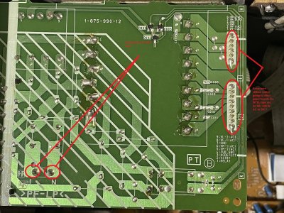

On the board, with multimeter I see 240V AC coming between L and N points on the board. (see attached picture)
On the board, J and I will be AC or DC? (see attached picture)
