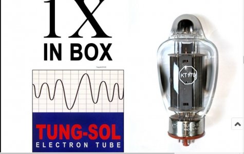

Or,...... there exists my 2023 design, the 6005 TRIPLE DC SE amp.
Or, ....... name it..................................... DCed..... KT88, KT150, and the new KT170.
The 6005 Output tube, as I employ it on HFV in 2021 and 2022, presently is easily my favorite sounding output tube, musically. Have not heard all 5 of these suggested amp Finals Tube iterations ( all would be two stage, DCed , SE, zero NFB . )
