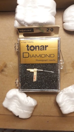

I could not find the stylus I got from UK, but I found another sealed box of stylus, which I had forgotten about. Picture attached. I had some old stylus too on which 78 were hardly played, or almost never played since they are too heavy to carry around while in service. But in absence of them, could this work with GP204 for Philips GC032 ?

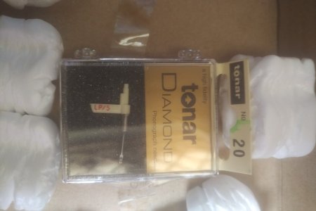

Just added a clearer photo.

Hi UcSam. The 3600L stylus will not fit on the EG1400.
Yes you can fit an AT 91 or AT 3600 cartridge on the GA 242. If I get a spare, new EG 1400 stylus soon I will let you know.
