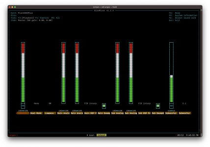

@ajuvignesh Sometimes volume is set to 0 for the device. If you login using terminal, you can type the command alsamixer. After that you will get a screen as below. Press F6 to select the sound card and see if the volume is at 100%.You can use the up and down arrrow key to select the volume. Pressing ESC key comes out of alsamixer

I will take your advice and check if the sound output is zero on the alsamixer.

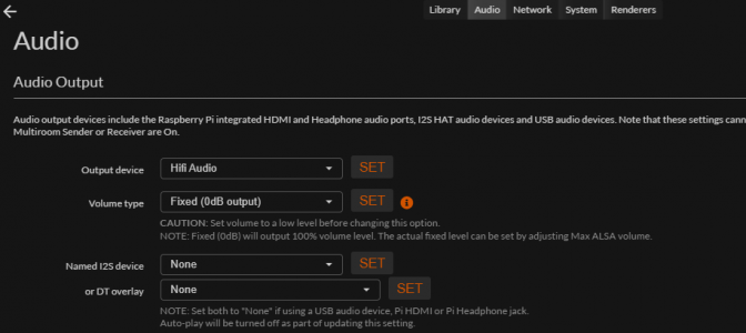

Thanks @mbhangui for tagging me here..
@ajuvignesh since you are using USB DAC with pi (Moode), you need to do some setting on the output audio device setting on Moode. But I haven't seen you have mentioned in any post.. Please follow the below steps..
a) Menu, Configure, Audio
b) Select "None" for I2S audio device then SET
c) Reboot
d) Menu, Configure, Audio
e) Under Output Device, select your USB DAC then SET
Also, once you logged into Moode cli through SSH, you can run the below command to see whether the device is detected or not..
pi@moode:~ $ dmesg |grep -i audio |grep USB
[ 2.562217] hid-generic 0003:0D8C:0158.0001: input,hidraw0: USB HID v1.11 Device [C-Media Electronics Inc. Hifi Audio] on usb-0000:01:00.0-1.3/input255
In my system, it shows my USB DAC as above, yours should show something different.

My moode audio settings screen looks as below.

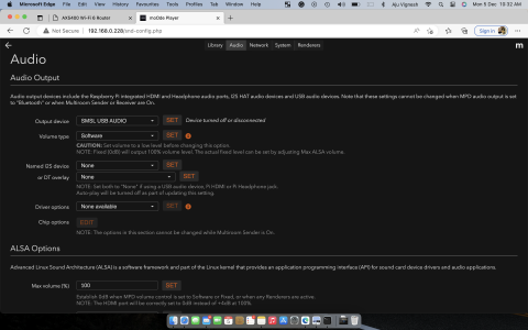

@premoddev 'pi@moode:~ $ dmesg |grep -i audio |grep USB'
This returned no result.
But
pi@moode:~ $ dmesg |grep -i audio did return something as below
"pi@moode:~ $ dmesg |grep -i audio
[ 5.067504] bcm2835_audio bcm2835_audio: card created with 4 channels
[ 5.134450] bcm2835_audio bcm2835_audio: card created with 4 channels"
and aplay -l this returned something like below.
**** List of PLAYBACK Hardware Devices ****
card 0: b1 [bcm2835 HDMI 1], device 0: bcm2835 HDMI 1 [bcm2835 HDMI 1]
Subdevices: 4/4
Subdevice #0: subdevice #0
Subdevice #1: subdevice #1
Subdevice #2: subdevice #2
Subdevice #3: subdevice #3
card 1: Headphones [bcm2835 Headphones], device 0: bcm2835 Headphones [bcm2835 Headphones]
Subdevices: 4/4

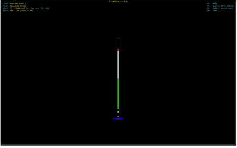

@mbhangui
I got this
I guess you were fine working an hour without any issues and then suddenly it started?
The commands you ran after the system stopped working? It's not showing the desired devices!!
Looks like your device is malfunctioning and need a service/replacement.
I still like to see the commands output when your system actually works... and then need to check the logs (/var/log/syslog) immediately after it start showing issues..
